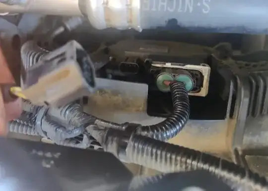

fan connectors
So as you can see, each fan appears to have two connectors, not just one. I managed to unplug one of them, but can't seem to figure out how to unplug the other type of connector. As you can see, it's pretty cramped in there so it's hard to get a good look, but it appears to me the white part should somehow be able to disengage and allow the remaining portion of the plug to come out, but I can't be sure. FYI, when I started the car with just the other connector unplugged, both fans continued to run, and I received a notification on the dash stating that Adaptive Cruise Control had been disabled.
Any tips on how to disconnect the larger looking cable? Thanks!

Handy Howie suggested that you try unplugging the fans one at a time to see if the noise is coming from one or both fans. If you can figure out how to unplug them, that’s an excellent idea. You may have to push this and pull that to disconnect the connector.
