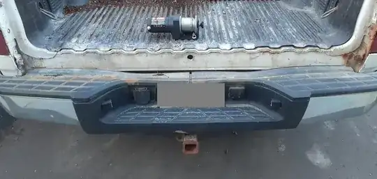

I have a 2010 1500 Silverado and a small ATV winch.
I want to use the winch to pull a lightweight aluminum boat up a slight incline.
I want to temporarily/occasionally attach the winch to the truck bed or rear bumper so that I can pull the boat and trailer up the incline to the truck.
  • I want the winch to pull the trailer hitch so that it's above the truck hitch. Reason: When the trailer is in position, I want to let the trailer hitch down onto the truck hitch.
How can I temporarily attach the winch to the truck bed or bumper?
My priority is quick & easy future installation. It can be a relatively lightweight setup since the boat and trailer don't weigh much. For what it's worth, I have a Back Rack installed on the truck.

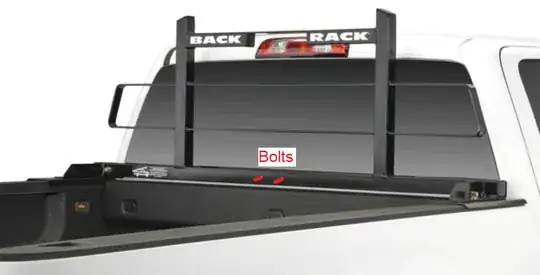

I wonder if I could attach the winch to the Back Rack:
  1. On the bottom cross member, drill two holes in the middle of the square tube.
  2. Install bolts into the holes. The heads of the bolts would be on the window-side of the rack.

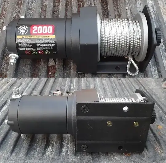

  1. Use the factory holes in the winch to attach the winch to the Back Rack. Thread a couple of wingnuts onto the bolts.
The winch would be positioned vertically, due to the placement of the factory holes in the winch plate.
Edit:
I wonder if winches are only designed to spool the cable when positioned horizontally. Maybe the cable would jam if the winch was mounted vertically.
Alternatively, I could use a U-Bolt on the bottom bar of the Back Rack to attach the winch. That way, the winch would be positioned horizontally, as designed.
This is the U-Bolt I used: Square U Bolt, Carbon Steel, Zinc-Plated, 3 x 2-in
