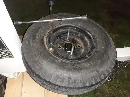

I'm installing a spare tire mount (U-bolt) on the tongue of my boat trailer.
https://www.princessauto.com/en/spare-trailer-tire-u-bolt-mount/product/PA0008007005
The tire mount/U-bolt's threads are quite long -- too long for my lug wrench to reach down over the threads to the lug nuts.
How can I tighten and untighten the lugs if the lug wrench doesn't reach?
The lug wrench fits the main trailer wheel lugs too. I'd prefer to only carry the one lug wrench tool with me, rather than add an additional spanner wrench, etc. to my trailer toolkit for the spare tire lugs.

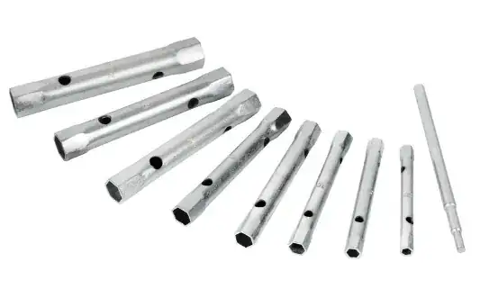

I agree with the answer by @Paulster2. However if you don't want to do any sawing, grinding or filing, you could buy a suitable box spanner, for example -
Product details from that website -
Make all kinds of jobs easier with this double-ended box spanner set. They're often used to remove fittings that are hard to reach, such as deeply set nuts or spark plugs tucked away in a recess.
The box spanners come with a soft tool roll to make organisation and transport easier. A 190 mm extension bar is also included, so you can get the maximum amount of leverage with the minimum amount of force. This means you can remove stubborn fittings with ease or ensure ultra-tight screwing.
Box spanners like these are often used by plumbers to install back nuts on taps, or by boat owners making adjustments to a marine engine installed in a confined space.
