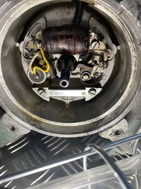

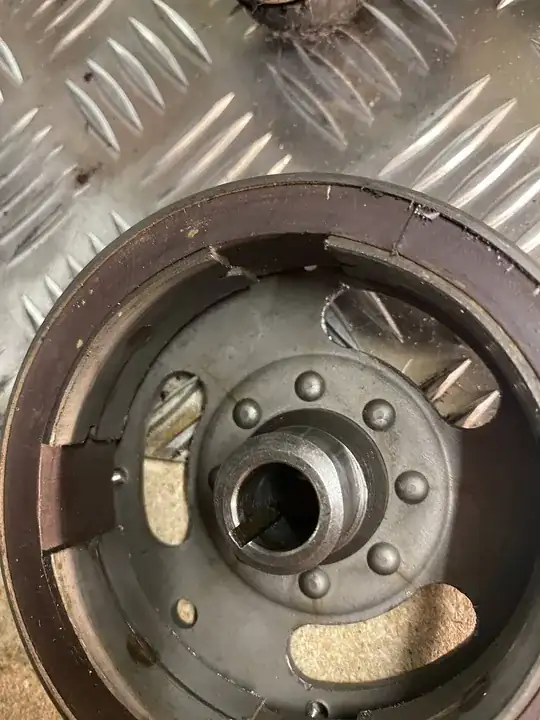

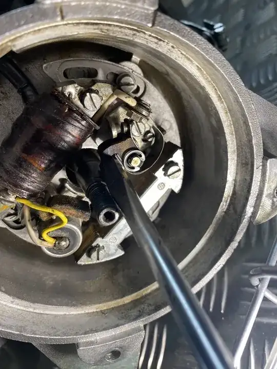

Below are a couple of images from the ignition module and the flywheel with the magnets and the indent that trips the points.
Ignition module with the points closed:
Ignition Module with points closed
Points openend
Ignition module with points open
Flywheel with indentation
Flywheel

This sounds like an issue with the magneto and points timing.
It may be possible that the magneto is not aligned properly. If the magneto and points timing are not aligned, then it could result in a weak spark.
