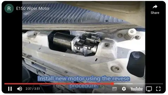

Wiper motors usually have a built-in switch that keeps the power on to the motor until the wipers are in the parked position. If this switch becomes faulty, one fault mode is the wipers keep running permanently.
When you say that you have bought a wiper modulator, I presume you mean wiper module or wiper motor.
The motor is located underneath the panel where the wiper arms attach as in this photo -
This video shows how to replace it.
