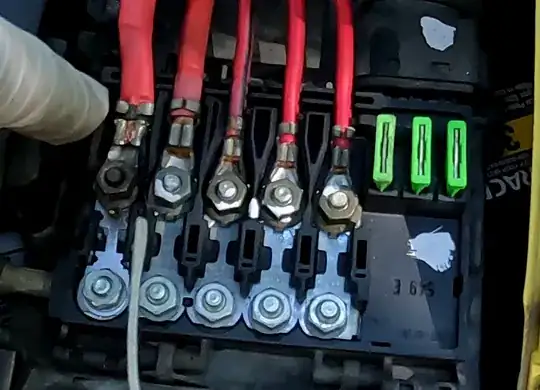

What other tests can I run to figure out what's going on here? I have read that some of the wiring in the box on top of the battery is a bit undersized -- there's some evidence that one of the wires (black, furthest to the left) may have been a bit toasty at one point in its life. It's not completely burnt, but the metal is not shiny, and the jacket looks like it's been cooked.

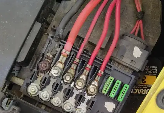

So I think that the problem was simply due to this wire having gotten a bit on the toasty side (see the black wire, which is actually positive, from the alternator?)
fuse box on top of VW beetle battery
In a feat of interesting choices, VW made this wire connected to the positive output of the alternator black. These metal straps are actually fuses - the one on the black wire was labeled 110A, and apparently failed to do its job or something since the wire got baked/oxidized, increasing its resistance, making it get hotter and more oxidized, and... well, yeah.
Where it was connected to the alternator was "ouch heck that's hot!" degrees. I didn't try checking here, and it wasn't until after I followed some advice from similar-ish symptoms from Pine Hollow Auto Diagnostics on YouTube (titled: "Dealer Tells Customer: "JUNK YOUR CAR!" (VW Beetle)"), specifically pulling apart the crimp, cleaning up the wire with Deoxit & sandpaper, that I thought to take some thermal images. Here's the cleaned terminals, you can see the much brighter copper
cleaned up terminals, kinda
thermal image of wires, indicating the three leftmost wires are all around 180F
I know on PHAD's video he was seeing >200F almost immediately. This was the temperatures after driving around town in 90F weather in direct sun. I'm not sure if that kind of heat still indicates an issue, but we had the same engine code with the air leakage as in the video, and we're not seeing that anymore.
So... it appears that the alternator is just fine as O'Reilly's reported, and there were(?) other electrical issues at play here.
