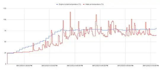

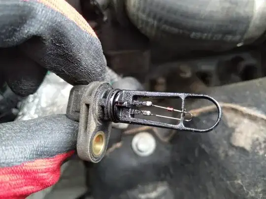

  • changed the intake air temperature (IAT) sensor: I've used an OBD logger to try and find anything strange, and I found it strange that the IAT sensor reports temperatures between ambient and 130°C and also some black debris on parts of it -- so I've replaced it, but that didn't help
OBD logger of IAT and coolant

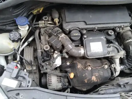

view under the hood:
view under the hood
old IAT sensor with some black debris:
old IAT sensor

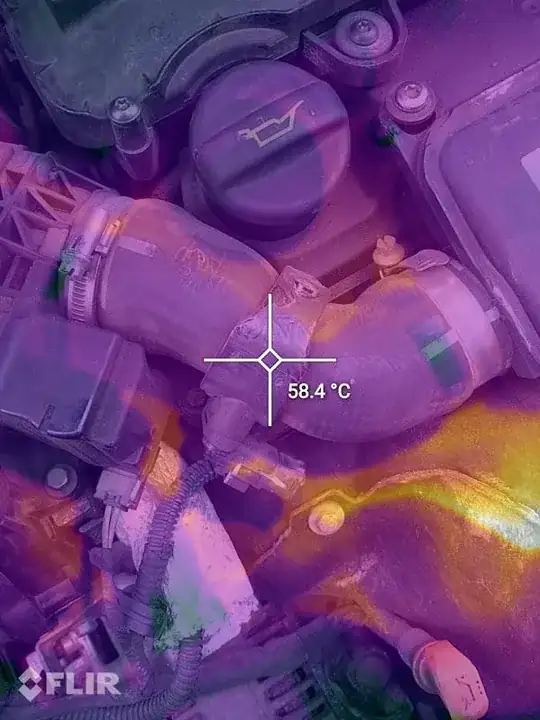

FLIR confirming the high IAT temps:

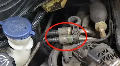

If your fuel supply line has a loose connection, a crack or a break somewhere, it could be letting air into the fuel line on the way to the injector pump. Diesels that I've known are pretty good at eliminating random bubbles from the fuel supply, but if operating at higher speed and under greater load, you may be momentarily exceeding the injector pump's ability to bypass air bubbles, leading to a momentary fuel starvation.
I've never been under the hood of a Peugeot, but this looks like the fuel supply and return lines:
If so, you might unclamp the fuel lines there and temporarily insert a short loop of clear hose so you can watch the fuel travel to the engine and back to the tank. You shouldn't see much air in the fuel going to the engine except an occasional small bubble. If you do, this may be the problem. Look for a break between there and the tank, or in the tank itself.
If there are no bubbles going to the engine but a lot of bubbles and perhaps long gaps of air returning to the tank, look for a loose fuel fitting at the fuel filter, the filter's water drain if there is one, or at the injector pump itself.
