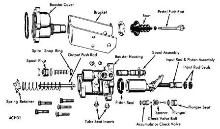

Is there anything else that could be causing this issue? I noticed when taking it apart the first time, there were some grooves on the spool valve where o-rings would be, but I don't remember seeing any the first time taking it apart, so I left it without o-rings. Could that be causing the issue?
Here is the diagram on the instructions that came with the rebuild kit:

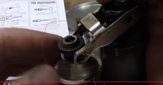

So it looks like the issue was that I did not attach the bracket arm (I don't know what you call it) that is on the input rod & piston assembly to the end of the head of the spool assembly. See the picture below:
These two need to be attached. There are no o-rings or seals that go on the spool assembly. After rebuilding the hydroboost again and making sure I done this step, the brakes worked properly again.
The source of the video where I made this screenshot is: https://youtu.be/1tr3vHl1zhA?si=8WNnEAwhvsXQaLH2
