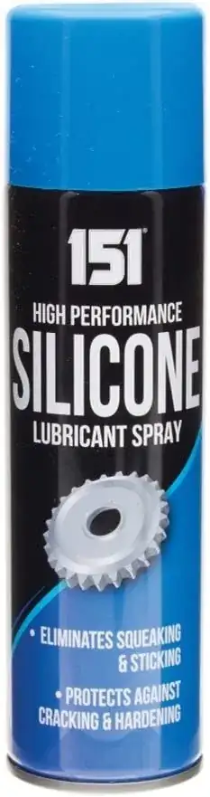

I would start by spraying all of the rubber guides that the window runs in with a silicone spray. Spray plenty on so that it runs down the guides that go inside the door. Wind the window up and down a few times so that it spreads out. If you apply this every now and then your windows should move a lot faster.
For example -
