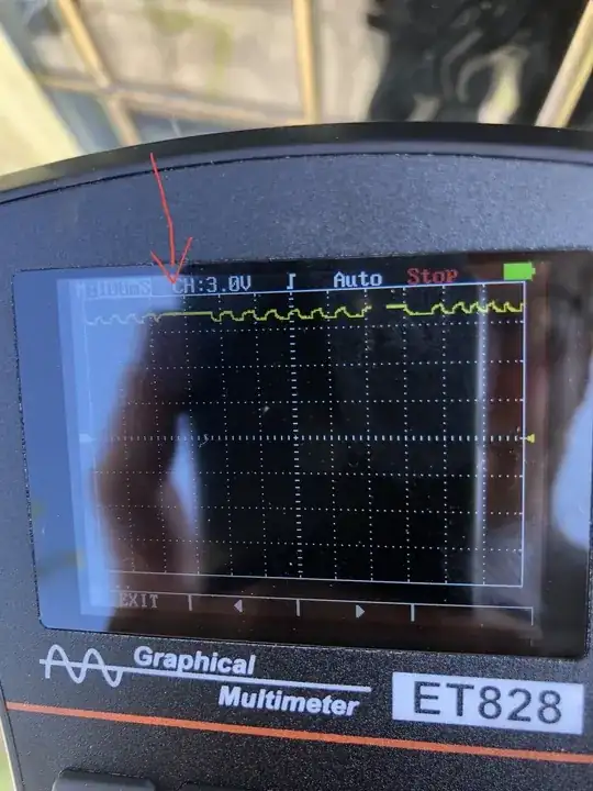

I have checked the signal from the abs sensor on a multimeter scope shown in the image ABS Signal
the flat part shown in the image occurs when the wheel is still spinning and is periodic. This implies to me that the reluctor ring was damaged when I fitted the new discs.
