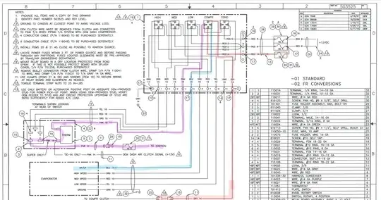

Listening very carefully (with the engine off to make it easier to hear), I turned the thermostat knob back and forth to listen to the relays. As shown in the wiring diagram below, the pink wire (highlighted purple here) triggers the condenser and compressor relays. I only hear one relay click when I turn the knob, even though I expect to hear two clicks. I know the condenser relay is coming on, because I hear the condenser fans, which means the relay that is not coming on is the compressor relay. (As noted above, I have tested the relay itself and verified that it is working. I have also checked the fuses.)
wiring diagram
My first assumption was that the high/low pressure switches (labeled "HP/LP" in the diagram; connected via the blue wire) are preventing the compressor from turning on (by not providing power to the relay). I further assumed that this would be low pressure due to a refrigerant leak, given the age of the vehicle.

If you have access to the pressure switches which engine is running (mind where your arm and fingers are), you could check which of them is closed. If you cannot put the multimeter probes in them, pull the electrical connector and see which one makes whatever relay was closed to open.
