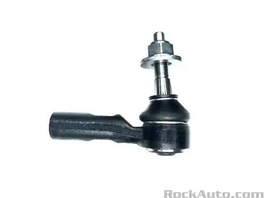

2018 Ram Rebel 4X4 crew cab with lift kit 18 x 12 rims with a negative 44 offset rims slightly rub on tie rod ends

No, you unfortunately cannot turn your tie rods upside down. The reason is, the post in the middle of the tie rod is tapered. If you tried to put it in upside down, the taper wouldn't seat properly.
