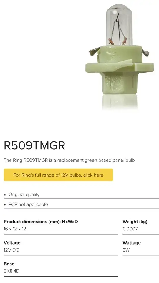

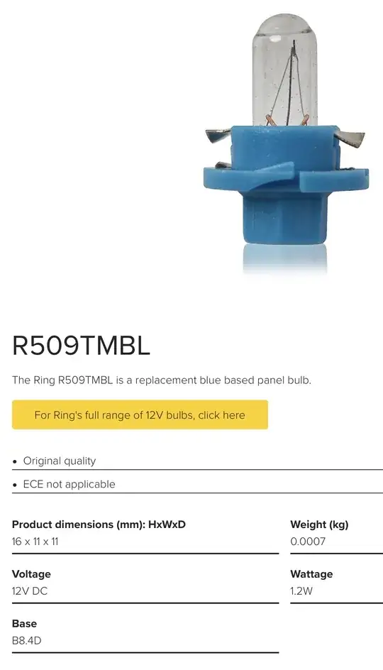

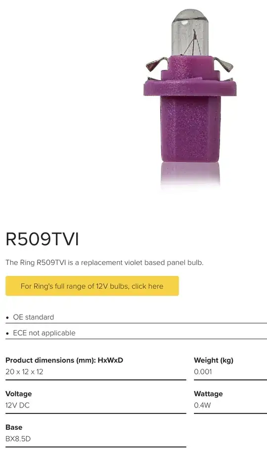

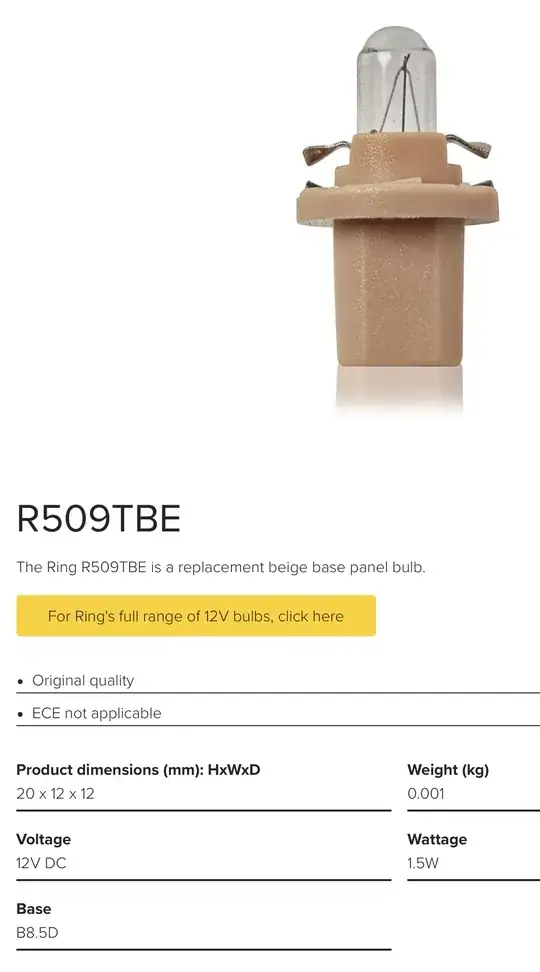

You can see the different shapes and dimensions of the bulb holders in these images that I collected from the Ring website. Probably best just pick the one that looks the same and has the same dimensions as the ones you have.
Ignore the weight and wattage, just focus on the base and dimensions.
enter image description here enter image description here enter image description here enter image description here
