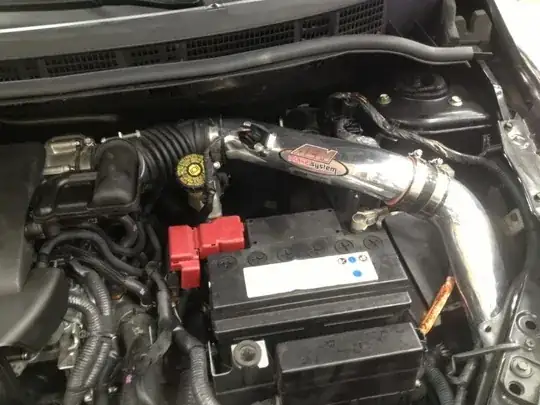

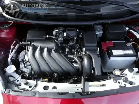

The battery of my Nissan Tiida is similar to the ones in the pictures below. Should I check if there is enough liquid inside? and in case it needs, should I add distilled water?

This battery type does not allow for easy checking and does not require it. If you had a battery with caps you could remove, then yes, you would use distilled water to top them off.

While it is normally not required with a maintenance free battery yours may be a low maintenance type. Allowing the battery acid level to drop too low can cause the battery to overheat shortening its life. The small circles with the cross pattern on the top are caps. They can be removed and water can be added. It is best to use distilled water. If you don't have a battery filler you can use a plastic turkey baster. It is important to add a little at a time and not overfill the cells.
