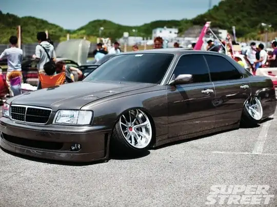

I've seen photographs of cars with strange inclined tires like the one in the picture I pasted here. They seems to be Japanese cars. Is it for drifting? Maybe for appearance? Do the tires get injuries? enter image description here

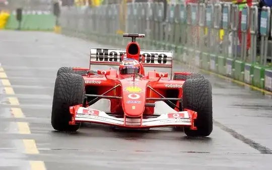

That extreme amount of camber on the car you showed is purely stylistic and would be horrible for both tire wear and handling, but lesser amounts of camber are common. For example, the negative camber angle is plainly visible on the wheels of this Ferrari F1 car.
image of a Ferrari F1 car displaying negative camber

In this specific example the car is more than likely using airbags. When you decrease or increase the height of a car it affects the tire alignment by usually causing positive camber, pushing the top of the tires outward, this is a highly modified suspension system.
This particular person has modified their suspension so the top of the tires tuck in when the airbags deflate so they don't hit the fender well. Which not possible with a dual wishbone configuration, so more than likely its a basic strut assembly.
Most people will adjust their cars for negative camber, this way during hard cornering when the tire deforms on the vertical axis you get the largest amount of rubber on the road. Most tuners overdo this past performance and into the realm of looking good.

The question assumes that the car is a drivable configuration, which may not be true. This car and similar photos you have seen probably have Height adjustable suspension this allows the ride height of the car to be changed on demand.
In all likelihood the frame of the car pictured is sitting on the ground. The suspension has been lowered (or tires raised) through a powered operator controlled method, until the tires are no longer supporting the car. There are several variables, but as you can see in the question image, the tires on the vehicle will not clear the body panels without being tipped in for the current ride height.

It is entirely for style.
This is called "camber".
The tires will wear in an odd manner. The tire contact with the road is usually a rectangle on the bottom of the tire. This extreme camber makes the contact patch very small and near the inside edge of the tire. This does significantly reduce grip.

The photo in the question is definitely a case of too much camber. That car is going to be undrivable in that configuration. If you drive like this, the sidewalls will come in contact with the road surface. The sidewalls aren't designed for this and the tire will fail soon. You also need gigantic tire pressure to avoid the rims hitting the tarmac.
Especially in Japanese car culture, some drivers employ really exaggerated modifications: front spoilers 50 cm long, tailpipes sticking out 2 m beyond the rear bumper, and 45° of camber.
In some cars (e.g. with swing axles as used on the VW Beetle), when you lower the suspension you automatically/inevitably get increased camber. With live axles and modern independent suspension this is much less pronounced. With double wishbone suspension it doesn't happen at all.
