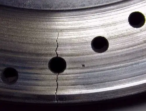

I would recommend you get slotted, but not drilled rotors. Regular rotors will work fine for typical track use. What is more important is the type of brake pad you purchase to go with your disks. The reason I suggest not getting drilled rotors is, they have a tendency to crack at the holes due to stress risers. They will not last as long as you'd like them to and will not give you much more performance than just the slotted ones will. The slotted rotors will provide space for allowing brake dust and such to be brought away from the pad, which keeps it clean and better intact with the rotor.

So why do all those high dollar cars like Ferrari, Lamborghini and Porsche have drilled rotors? Well, because people think it looks cool. The rotors on those cars fail when pushed hard as well, and the professional race teams that run these cars replace them with non-drilled rotors.

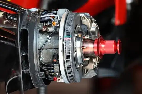

F1
Image from formula1.com The brake rotor on an F1 racing car is not cross-drilled nor slotted.

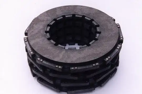

Aircraft
This undrilled, unslotted brake rotor stops a 100-ton vehicle from 185 MPH in 2500 feet of tarmac.
