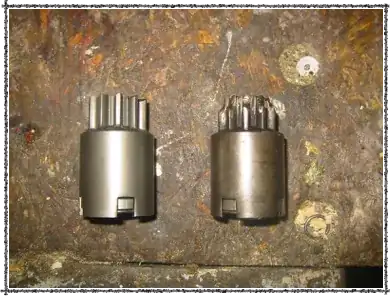

One possible fault is that the starter pinion teeth have been damaged like in this photo -
It may be that the mechanism on the starter motor that throws this pinon into the matching teeth on the flywheel is not working correctly. This could be due to a seized bendix or a faulty solenoid mechanism.

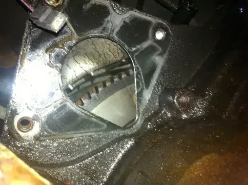

Finally, there may be a section of damaged teeth on the flywheel that the starter motor pinion meshes with. This photo shows a section of good teeth on the flywheel viewed at the starter motor mounting location.
It is generally a relatively simple job to replace a starter motor. It is best not to repeat the grinding of the teeth, since replacing the flywheel is a much bigger job and repeated grinding may damage the flywheel teeth.
If the issue is due to a damaged section of teeth on the flywheel, it may be possible to first turn the engine a little using a wrench on the front pulley, so that a good section of teeth meet the starter pinion when you try to start the engine.
