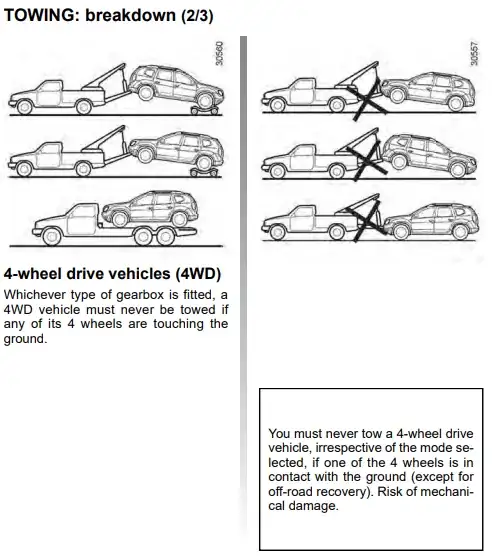

I have a 2017 Duster 4x4 and want to tow it behind my motorhome on a trailer dolly which holds the front wheels. The rear wheels will still turn so I was concerned this may damage the 4 wheel drive system.

I found this in the owners manual for the vehicle, which says that it must not be towed with any wheels on the ground -
