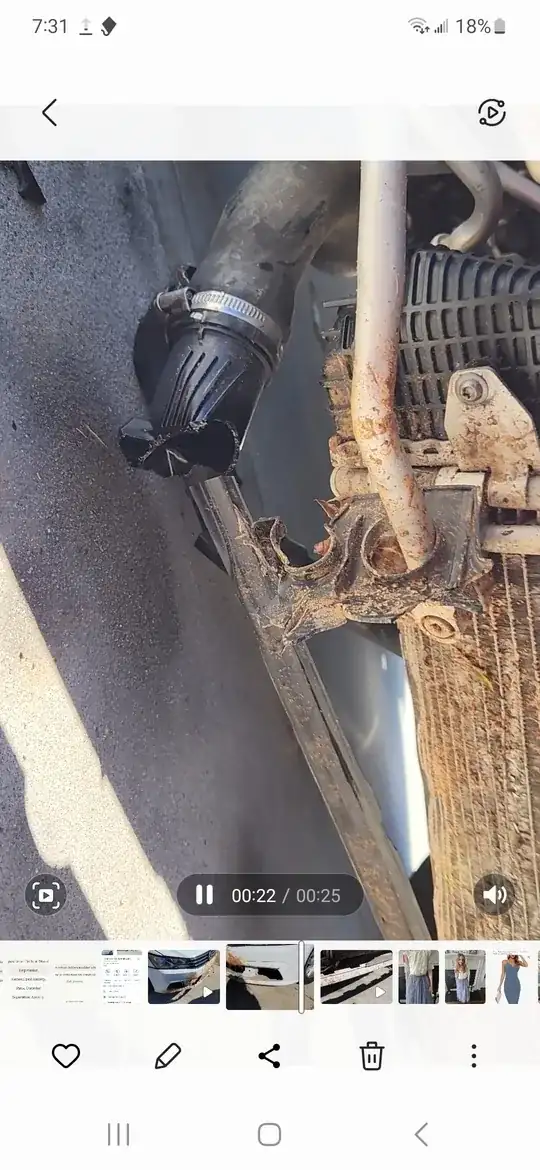

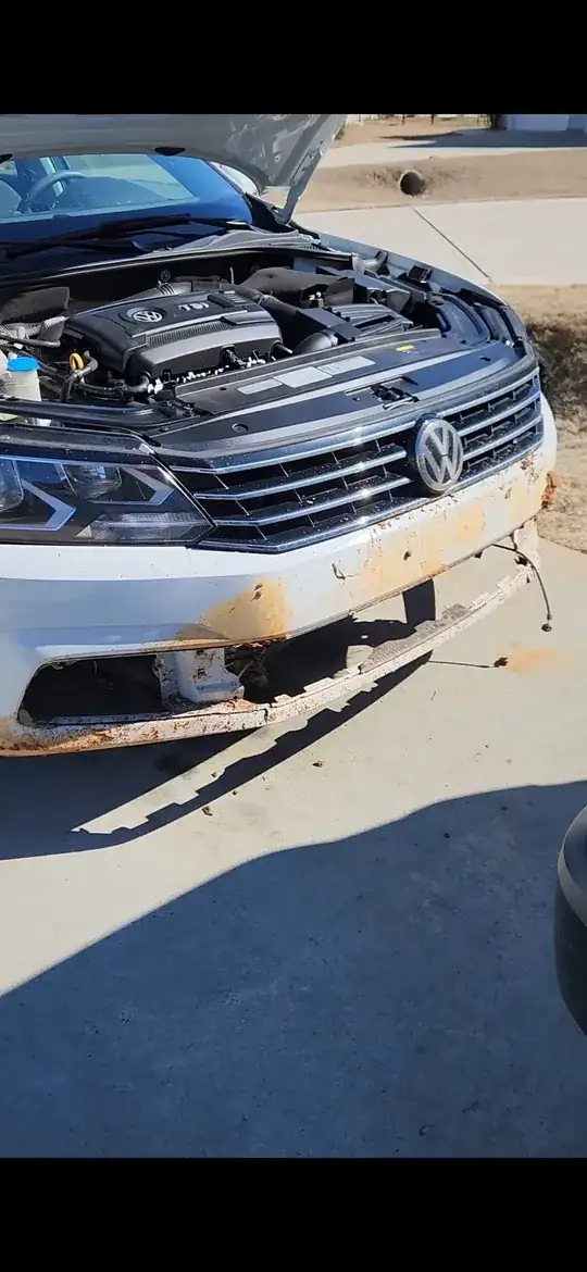

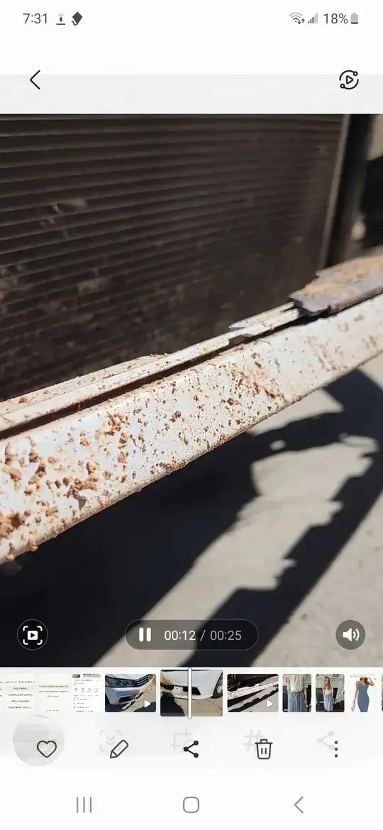

  1. Front damage to bumperradiatorhangingcracked radiatorand busted hose
To avoid an accident I swerved into a ditch and my front end slammed down. My radiator is hanging and I know somthing cracked cause I smelled it. I was 5min from home, was able to drive home and no air bags deployed. Hope likely is out that my car is repairable or does this mean total loss? It is a 2017 VW Passat

Now to your specific question: Only someone who knows auto repair can determine if it's repairable or not but generally unless the car looks as if it came out of a crushing machine, it's repairable. Either assess the damage yourself and get some quotes for parts and any repairs you cannot do yourself or take it to a shop you trust and get their estimate. Insurance companies usually have "adjusters" who will take a look, usually a quick look, and make an estimate. They may or may not be all that accurate.
