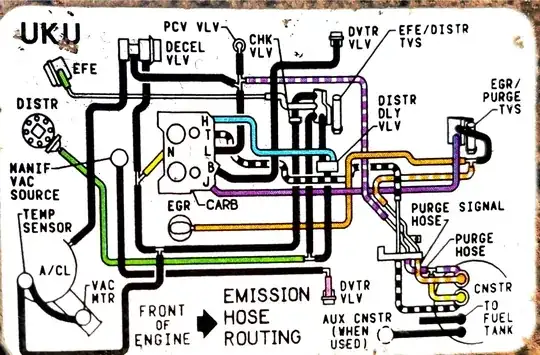

Here is a picture of my vacuum diagram for the emissions system.
emissions system vacuum diagram for 1985 Chevrolet G30 5.7L
