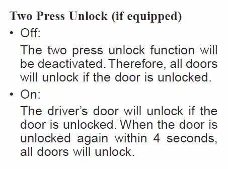

With due acknowledgement to @Old_Fossil, go to your car's manual, chapter 4, page 70 and see how to control the LCD display so that you can change modes and user settings.
Then see chapter 4, page 78-79 for door settings. Turn off the "Two Press Unlock" function.
Credit: Kia Motors
