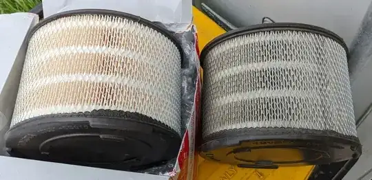

A quick search identified potential causes, and I went to check the air filter. Jeez! So, I got a new one. Here they compare:

So, apparently (and hopefully) the cause was indeed the air filter.
But I am struggling to understand the mechanics of the above behavior. If the stalling was caused by insufficient air pressure on low revs due to the air filter being clogged, then replacing it should have fixed the issue immediately. But instead, the issue appears to have gradually faded away.
Perhaps, the immediate cause was dust contamination of some engine parts due to the old filter letting some dust through? And now, the flow of clean air has cleared that out? But how exactly would that cause the engine stall on low revs?
