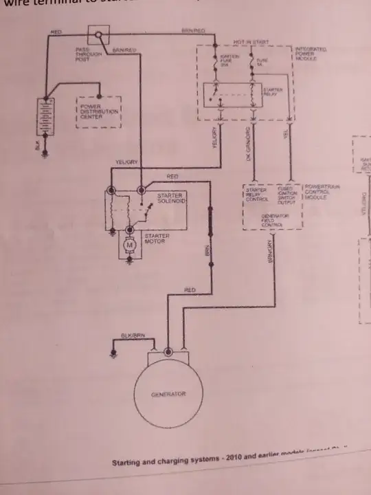

So it seems like the issue is somewhere else but the simple wiring diagram (attached) in the Haynes manual I bought doesn't show much other than what we tested. It shows some inputs to the PCM/ECU but I'm not sure how I would be able to test any of that. From looking online I have seen that the ignition switch may be the issue but I don't see how that ties in on the wiring diagram either, plus the relay is clicking and works so I don't see why the engine/starter won't spin.
Starter Wiring Diagram
I guess I am stuck because we can get the starter to turn by just jumping the relay, we have confirmed the relay works, and the relay appears to click when the key is turned. However, the starter never spins when the key is turned, so I'm not sure what I am missing. I can't really check what the PCM/ECU is thinking so there may be some other condition that isn't being met but I am not aware of it.

Remove the starter relay from its socket and connect a 12v bulb (something like 5w) across what would be the relay coil contacts in the socket. You should be able to just push some wires into the socket connectors, or do a better job with crimp-on spade connectors.
If when you turn the ignition the bulb lights brightly, then clearly you have enough current flowing to operate the relay.
If this works, and if as you said jumping the switch side of the relay makes the starter turn, then the the starter relay is clearly at fault.
Update after finding out that you have swapped relays:
With many automotive relays, it is possible to pop the case open and operate them manually. You could try opening the relay and watching to see if the relay is getting fully energised. You could also give some manual assistance to see if when the contacts close properly that the starter motor turns.
You hear a click -- how do you know it's the starter relay that's clicking? There are other relays in the car. Put a meter on the starter relay terminal and ground and see if it's getting 12V when you turn the key to the start position. If not, you are hearing a different relay's click, not the starter relay. That would suggest an issue with the ignition switch or with a fuse related to the ignition switch.
