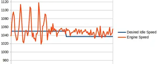

There is a Glow time relay parameter, which goes from Active 0V to Inactive 12V after 60 seconds (glow plugs?). Although I mentioned the problems appear in the summer, I can notice a slightly rough idle even now (much worse in the summer, from 500-1500 rpm, stalling the engine). This rough idle is evident on a chart (see excerpt below, it includes seconds 103-180). It suddenly resolves itself after about 130 seconds from start, with no apparent reason (checked all parameters to see if any one changes simultaneously, but no, well, except for coolant temperature, which goes from 19°C to 20°C).

Use your scan tool to check the coolant temperature when the engine is cold and when it is hot. If either temperature is not plausible, you may need a new coolant temperature sensor. If your car also has an air temperature sensor, verify that one too.
I don't know your particular engine, but some small diesel engines run the glow plugs not just for starting but also intermittently while the engine is warming up from a cold start. If the engine is already warm when it is started, the glow plugs don't run.
If your coolant temperature sensor or air temperature sensor is falsely reporting a temperature that is higher than it really is, then the ECU in the summer may think the engine is already warm, so it is not getting extra help for good combustion from the glow plugs. In the winter, the sensor may indicate "cool" instead of "cold", but this may be enough to cause the glow plugs to run.
