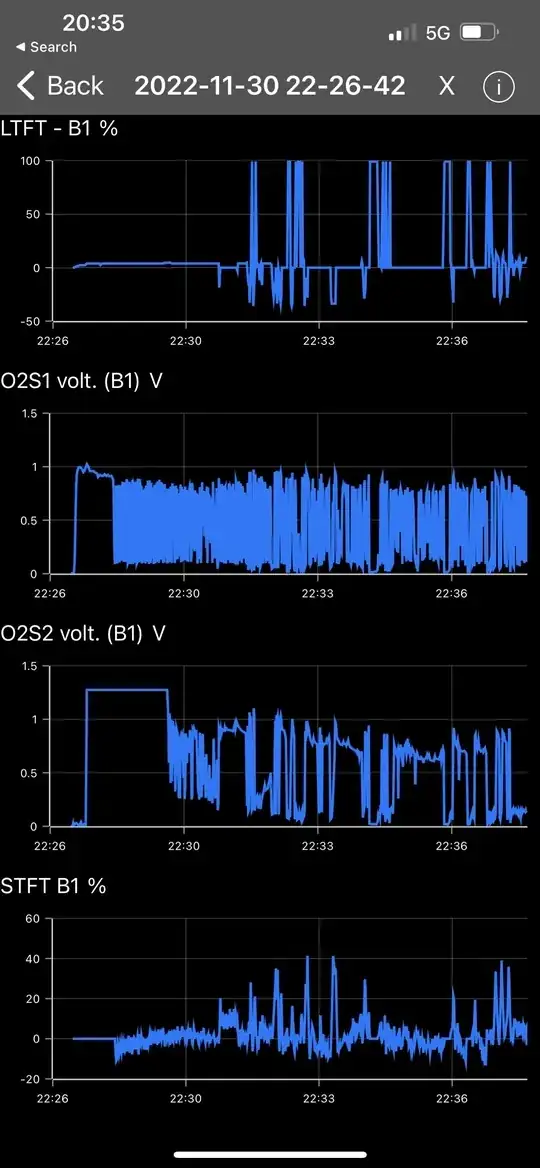

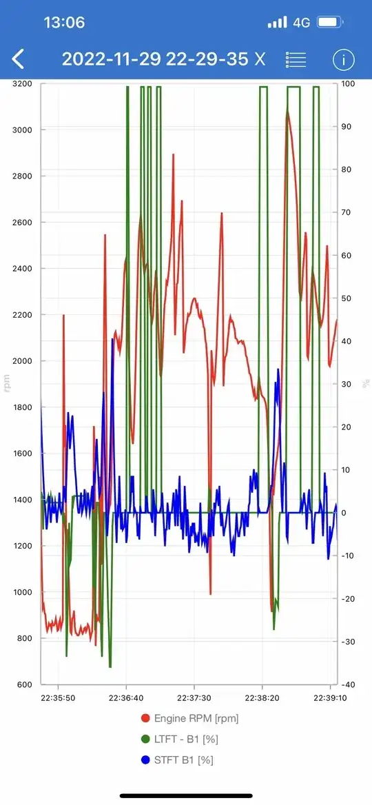

I have attached a live data scan of a short journey which shows erratic LTFT is this normal?
Anyone else come across this problem before?

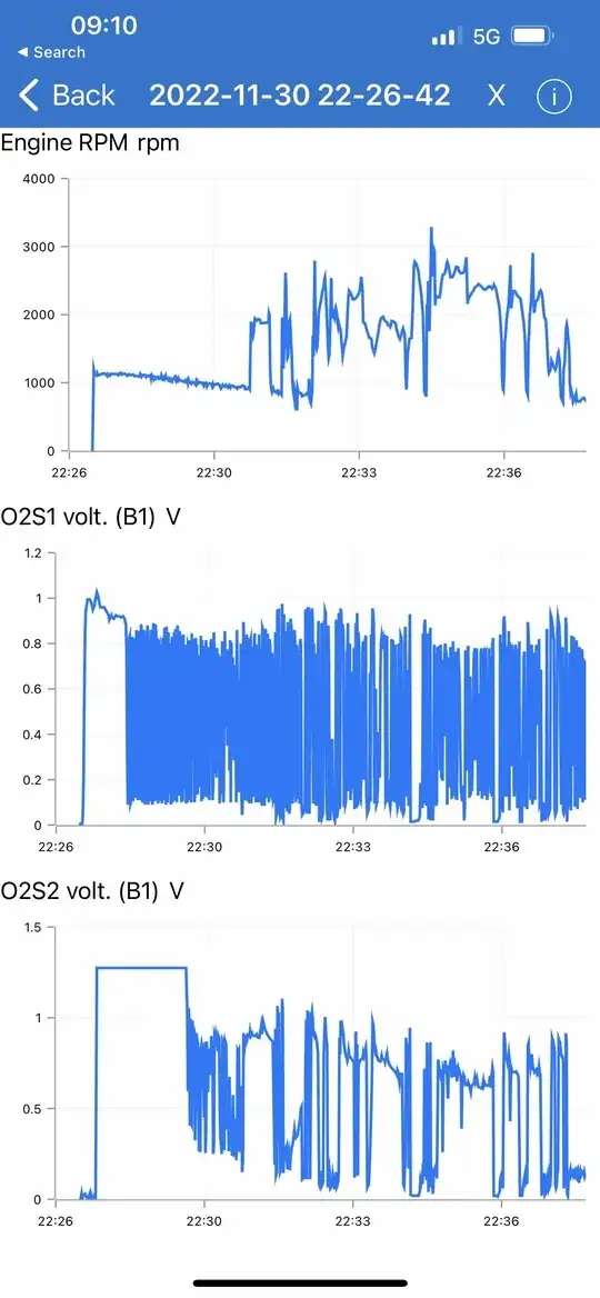

One item I forgot to list above was that I have previously checked the coolant temperature sensor and it read correctly, I don’t appear to have an oil temperature sensor on my scanner for this vehicle. I have added a further snap shop with the oxygen sensors also attached.

I’ve run this scan, not sure if it helps

I'm not a fan of using fuel trim values to diagnose engine problems, there's a lot of rabbit holes there. The fluctuation of the long term trims is certainly an indicator something isn't right, it's just working out what is wrong from trims has never worked for me, although others may have a better answer. The shifts in the data could be an artifact of the OBD reader, the software you use to interpret it, or the sign of a different issue. Instead I suggest working on the symptoms that are more straightforward, and I don't think you have exhausted the possibilities yet.
