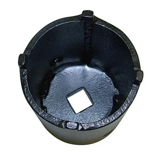

-I am trying to change the rotors on a 1978 Jeep Wagoneer (5.9L 4WD, Quadtrac), but in order to do that I need a special tool to remove the socket that holds the rotor, I don't know what tool that is. I asked the employees at O'Reily's but they don't seem to have a clue about what I am talking about.
I believe it's something like this tool as you need to remove the wheel hub in order to get the brake rotor off:

Your Jeep most likely came with a Dana 44 front axle with open knuckles. How ever on a vehicle that old anything is likely to have been changed. The tool @jwh20 has posted the image of is referred to as a Spindle Nut Socket. Since you mentioned O'Reillys their part number is 15002-01. I would suggest removing the dust cap from the spindle and verifying this socket will fit your spindle nut. You could also take a photo of the nut and get a match that way. There are a few sizes and pin configurations' but getting a match shouldn't be difficult now that you know what to ask for.
