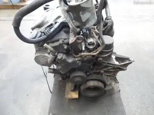

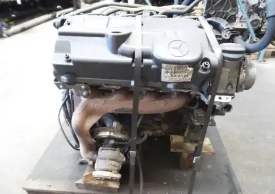

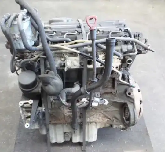

An alternative to repairing the engine may be to replace it (I found an engine for a model at least similar to mine, if not the same; the engine is sligthly different from mine but might be the more powerful option that was proposed for the same model) for what seems to me to be a cheap price for an engine (400€).
Now I don't have enough money to buy it nor do I know for sure it would fit, but since I cannot know for sure that a head gasket replacement alone will repair my engine and that repair anyways would cost a lot of time, I'd like to know whether or not to try to pursue this alternative a bit further.

  • See images herearfter.
enter image description here enter image description here enter image description here

If it were me (and this is strictly my opinion), I would probably go after the younger engine if you can get some kind of assurance on the maintenance and possible some kind of warranty on it. The reasons I'd go this route is:
  • It is younger engine is younger (obviously). Once you replace the head gasket on your old engine, you still have an old engine ... what's next to go?
  • Once you've paid for the head gasket repair on the old engine, how much more money would it take to just get the younger one? Paying that little bit more now might save you bigger in the future (if you can afford it).
