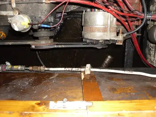

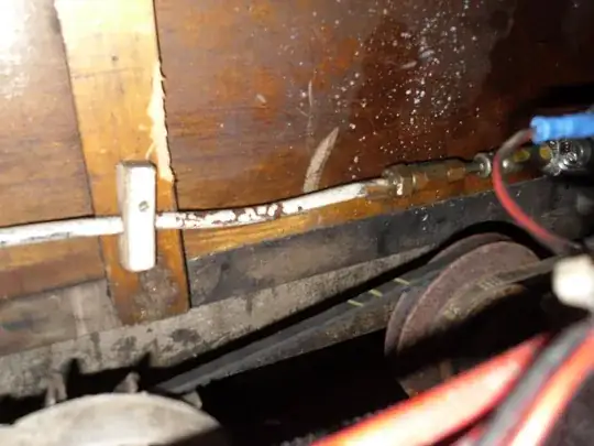

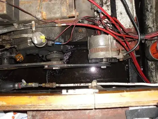

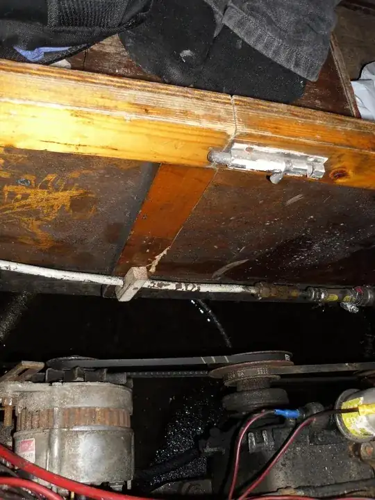

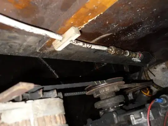

I've got a diesel engine in my boat, but the previous owner had somehow snapped the alternator bracket, and fitted it fixed to the boat rather than the engine. Now the alternator doesn't move when the engine rocks putting strain on the belt. The belt then stretches, so I have to adjust the alternator until the belt is tight. Repeat until belt snaps and fit another belt.
Making an engine bracket is out of the question at the moment as it would require welding a bracket to the engine casing, and it's not practical at the moment.
I was wondering about making some sort of DIY spring tensioner. The Belt runs parallel to a wooden 'wall', with a clearance of about 4 inches. I was wondering if I could attach some sort of device to the wall to intercept the belt at a right angle, (with a wheel / spring combo) and apply pressure to the belt to take the strain of the engine rocking when running.
Has anyone any idea how I can do this? I'm not sure what the parts would be called and I've searched the web to no avail.
I suppose it's something like this with a custom arm and a wheel for the belt to move in but I'm not great a mechanics to be honest. The link looks like a heavy duty one from America, but I'm after something I can make up cheap from a shop in the UK.
Here are some photos

So, bear with me on this and maybe I can help. Mind you, none of what I'm going to say is going to be easy to do, but that is because your issue is not an easy one to solve. The main problems I see here with any solution is alignment and distance from any mounting point I can discern. My main thought here is you need to get the alternator connected back to the engine and off of the boat. In two of your pictures, I have circled some areas which may be points you can use as mount points for what I'm going to suggest.
In the first picture, there appears to be a water pump with three bolts that are visible. I don't know if these bolts attach to blind holes or go into a water jacket in the engine, so be aware of water leakage. If these bolts are not long enough to mount something off of, you can take a bolt down to a local hardware store (maybe you have a Fastenal in your area) and find a longer bolt with the same thread pitch or find a stud (this is where Fastenal would come in) which is long enough to replace the bolt on the pump side and have the other side protrude which you can attach a brace to. Attaching to two or more brace points (two braces connected or not) would be better.
water pump bolts
In the second image, I see possible mount points which appear to be where the engine mounts to the boat itself. Underneath of this, I'm assuming is some type of rubber mount, but the top part, where the very rusty nuts are at, could be used as another mounting point. Also, there is a circle on the back of the alternator showing a bolt in the alternator which can probably used as a mount point on the alternator side to help secure it. In either of these cases, the alternator may be needed to moved or rotated to achieve your goal.
Engine motor mount points
In both of these situations, welding would help, but would not be needed as you can pick up some 1/8" to 3/16" thick metal strapping which can be bent in a vise and drilled to create the right sized holes. You may need to get creative to make something happen, but with a little bit of ingenuity can be done with good results. Alignment of the alternator is key, or you'll be wearing belts out or they will tend to jump off of the alternator. Even if off a small amount can cause issues.
