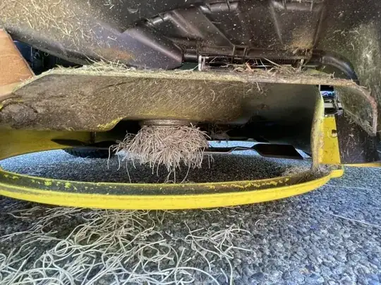

I accidentally ran over a hammock on the ground with my John Deere S100, and now the string is stuck in the blade.
I tried using scissors and bolt cutters, but I am only able to cut out the outer part of the strings that were stuck.
The inner part is very tight. Scissors are not an option because it is too weak, and bolt cutters are not flexible enough.
Here is a picture of what it looks like:
Can anyone help me? I don’t know what to do.

Take the blade off of the mower. There should be a single bolt in the center. Should allow you to get to the string easier and clear it from the blade and the shaft.
