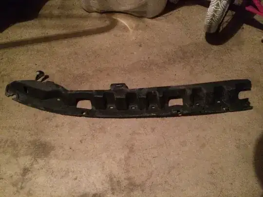

I drive a 2008 Honda Fit, and yesterday I found this on my driveway, resting under my front end. I know little to nothing about cars, but this looks simple enough that I think I could replace it if I only knew what it was.
Judging by the location of the rest of the part (this is the passenger side; the driver's side is still attached), this seems to be some kind of protective piece that keeps debris from ending up in my radiator from below.
So, Internet people who are smarter than me about this sort of thing: what is this dingus?

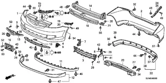

That looks like the front edge of a splash shield (for certain values of "front"). You're right that it is protecting things coming up from below: splashes, sand and general road gunk. It's also likely part of the aerodynamics of the vehicle (admittedly a very small part).
The link above is to an example vendor (who's selling the linked part for approximately $30 US). However, here's a more complete breakdown of the parts in that area:
As you can see, there are a lot of little trim bits. None of them are super critical but I'm sure it's annoying to drive around without them (so tacky!).
