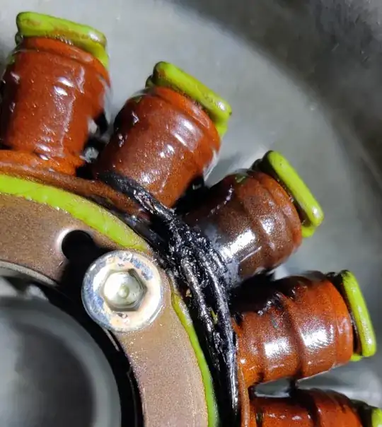

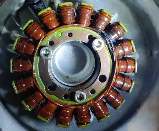

So yesterday I stopped for gas and when I tried starting the bike again it did not work. After some google-ing I found it was probably the stator. When I opened up the bike the stator had a burn spot. My question is, what might have caused this? enter image description here enter image description here

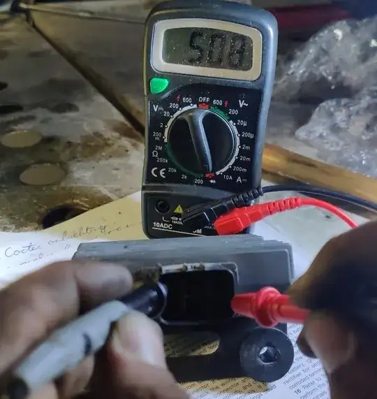

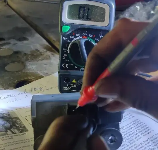

In this post (Kawasaki EX650 - What causes a stator to burn out?) there was talk about the rectifier being bad. However, I tested it. And I believe it's working as it should. enter image description here enter image description here
(I did this test for all 3 of the bottom pins getting the same result. When running the tests for the top right pin instead of the top left the results were reversed. Which is good I believe.)

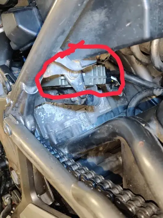

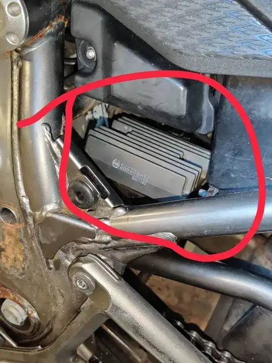

Location of rectifier:
