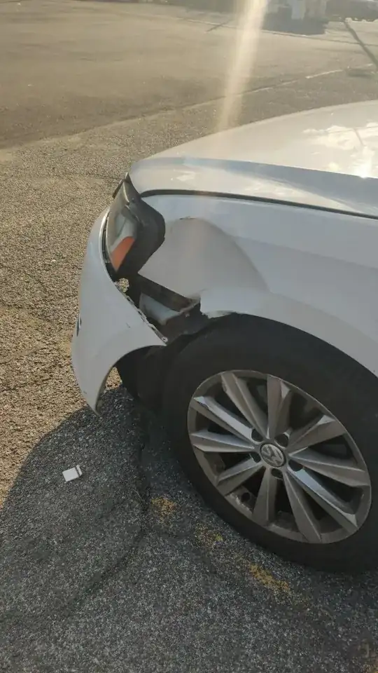

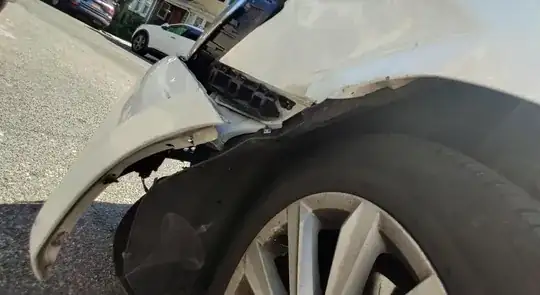

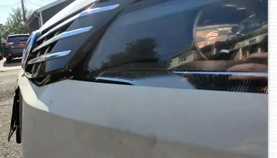

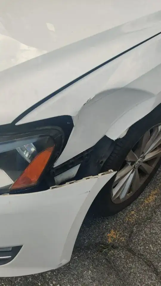

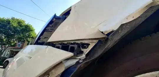

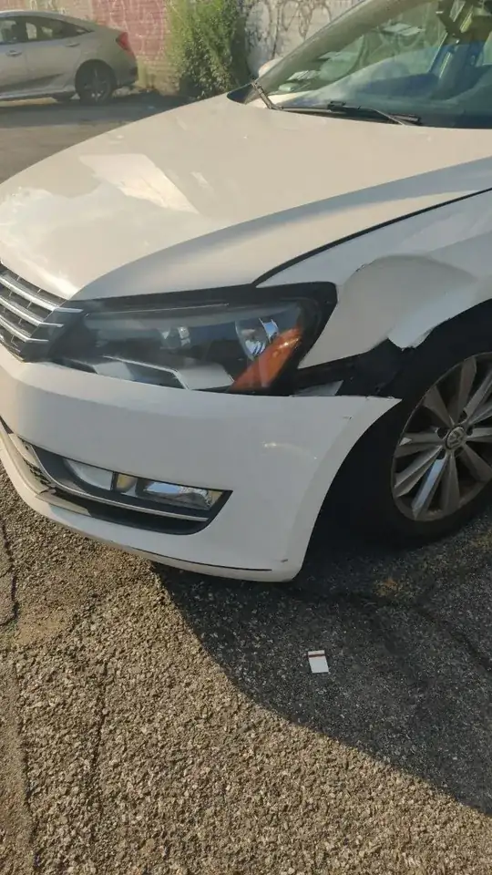

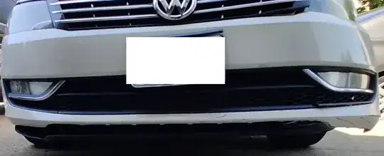

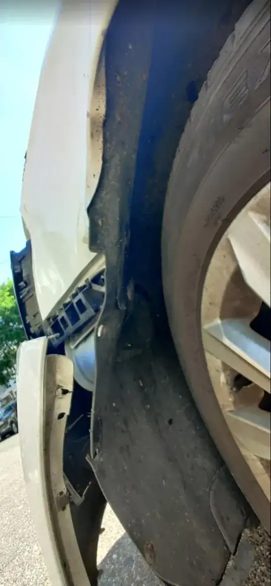

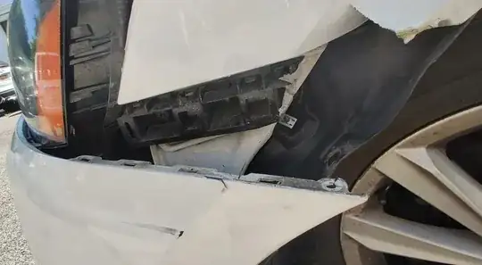

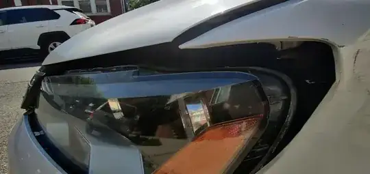

Hit a garage gate pole. Seems that the metal fender is bent quite well, and the bumper clamp area is also broken, hence its dislodged. What would you estimate would need to be repaired/replaced in this 2012 VW Passat?
enter image description here enter image description here enter image description here enter image description here enter image description here enter image description here enter image description here enter image description here enter image description here enter image description here enter image description here

The metal fender needs re-shaping; a good body shop can repair the existing fender piece. The fender will then need to be painted to match the other panels on the car.
The bumper cover (the plastic piece that reaches around the front of the vehicle) has been pulled out of alignment. Often when this happens, the small plastic fittings (you can see four of them on the top edge in the first photo) are broken, and the bumper cover then needs to be replaced. The first photo, however, shows the four fittings in good shape.
What we cannot see is what kind of shape the other side of the connection is, which is on whatever the visible fittings connect to. That other side piece may be damaged and require replacement. In addition, while I don't see any big scrapes in the plastic, there may be cosmetic damage to the bumper cover that would require surface work (filling and sanding) as well as painting.
EDIT 6-14-22
I think @Criggie's comment is spot on: the headlight looks askew, and its mounts (or even itself) are likely damaged too. It is, unfortunately, a common experience that when digging into a body repair, as one digs one exposes more damage.

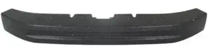

    • A/M CAPA Absorber: 561807248 @ $66.67 enter image description here

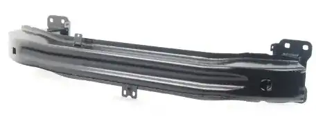

    • LKQ Impact bar +25%: 561807109 @ $187.50 enter image description here

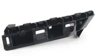

    • A/M LT Guide bracket 561807183A @ $13.72 enter image description here

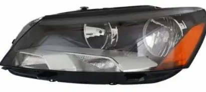

    • A/M CAPA LT Headlamp assy: 561941005D @ $228.33 enter image description here

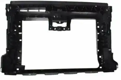

    • LKQ Radiator support +25%: 561805588B9B9 @ $250.00 enter image description here

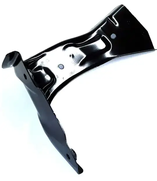

    • A/M LT Front bracket: 561821135A @ $28.33 enter image description here

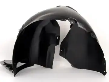

    • A/M LT Fender liner: 561805911B9B9 @ $69.58 enter image description here

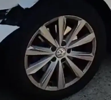

    • LT/Front Wheel, alloy +25%: @ $125.00
      • which is weird enough, because the rim was scratched, but they supposedly replaced it.

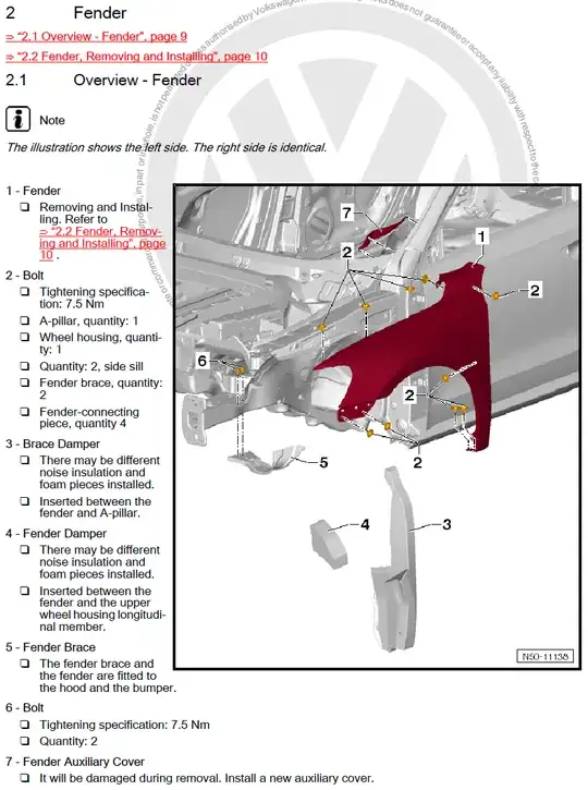

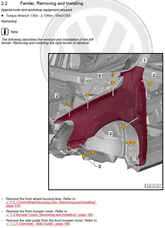

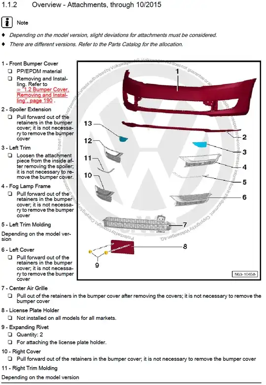

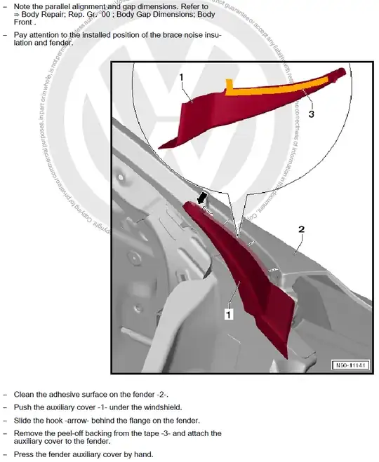

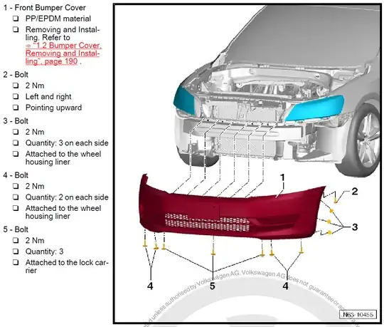

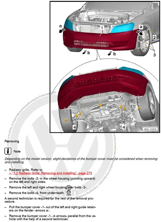

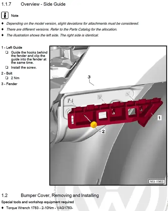

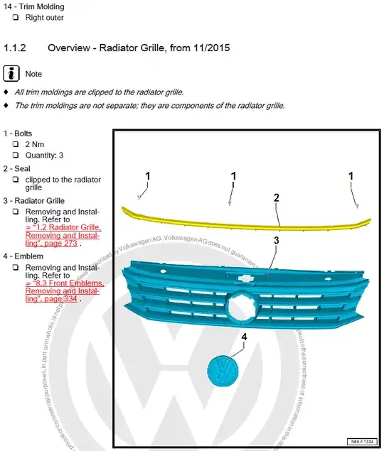

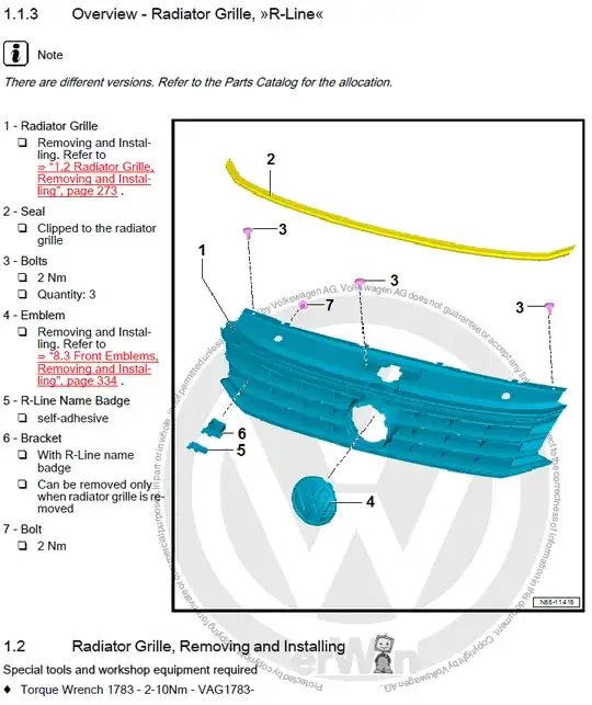

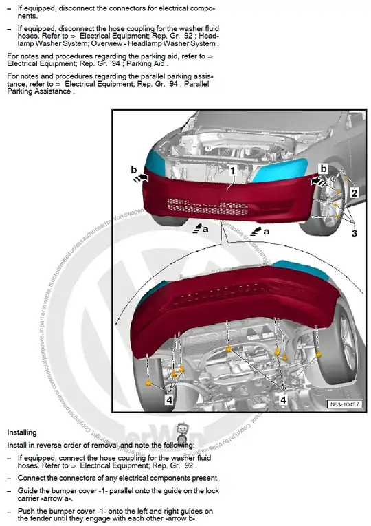

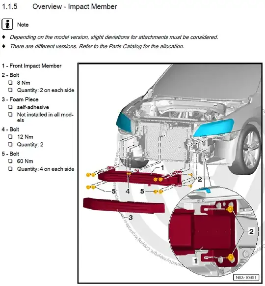

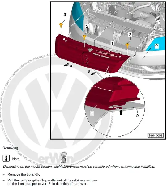

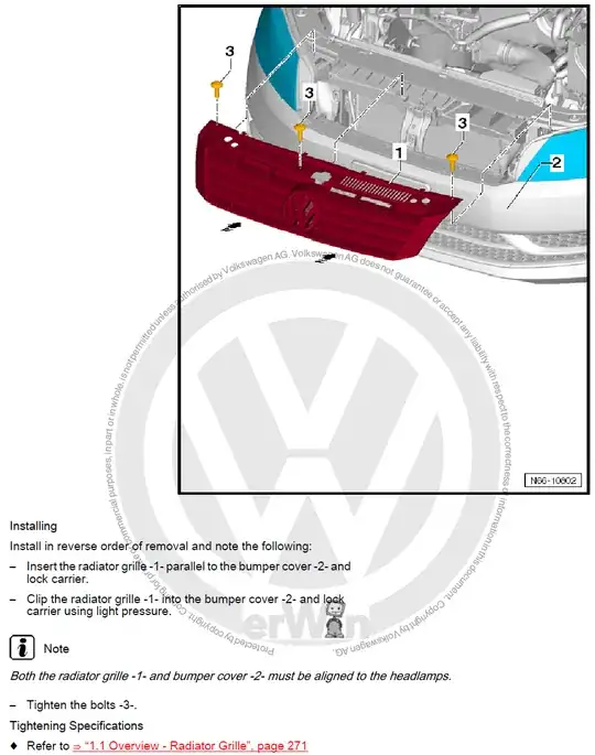

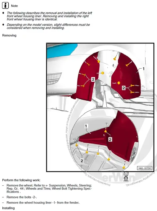

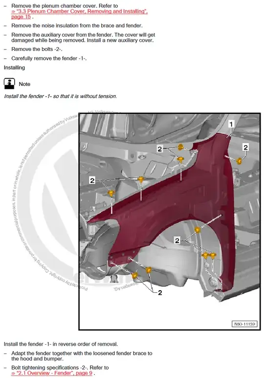

ON a different note, I have the repair manual for the VW Passat and will share here for reference:

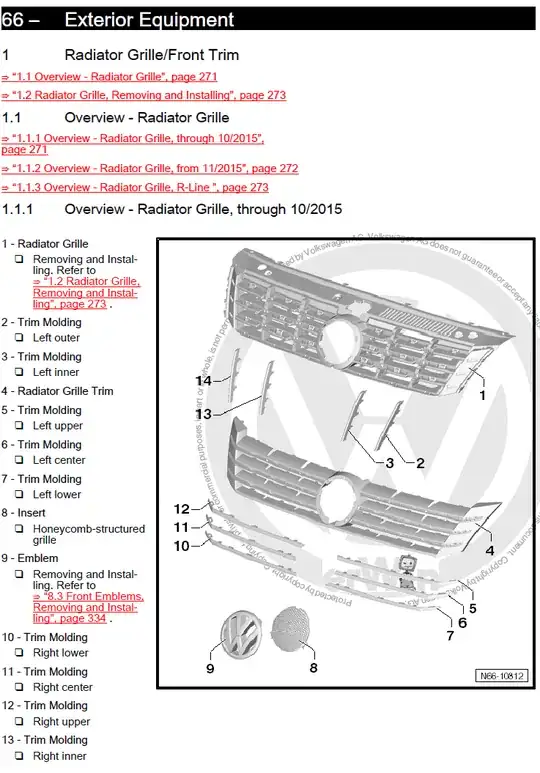

Grill Overview:

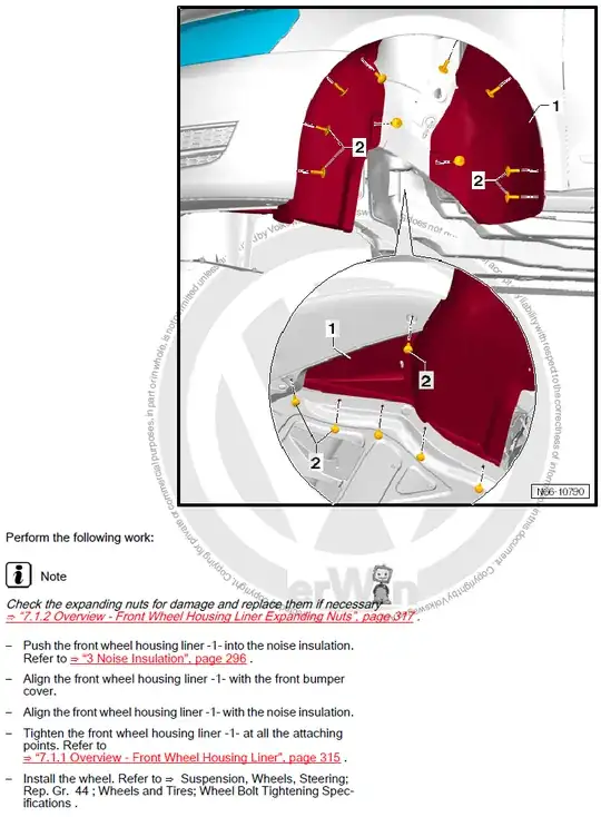

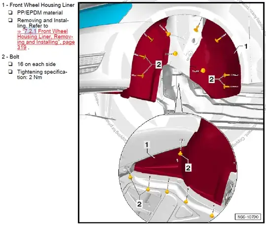

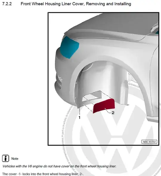

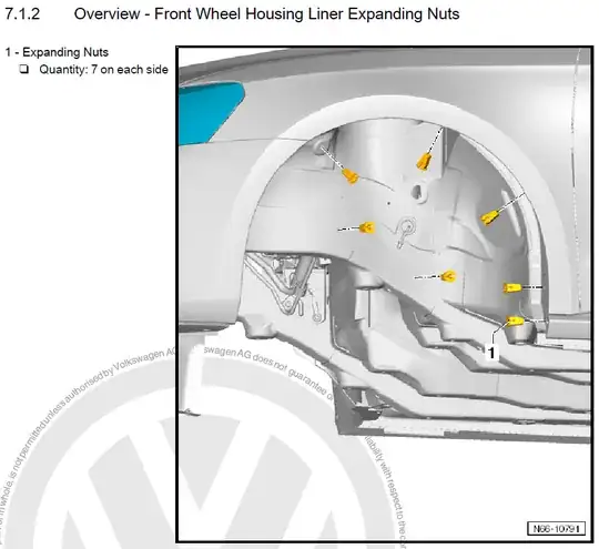

Removing and Installing the Front Wheel Housing Liner:

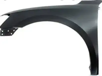

Fender:

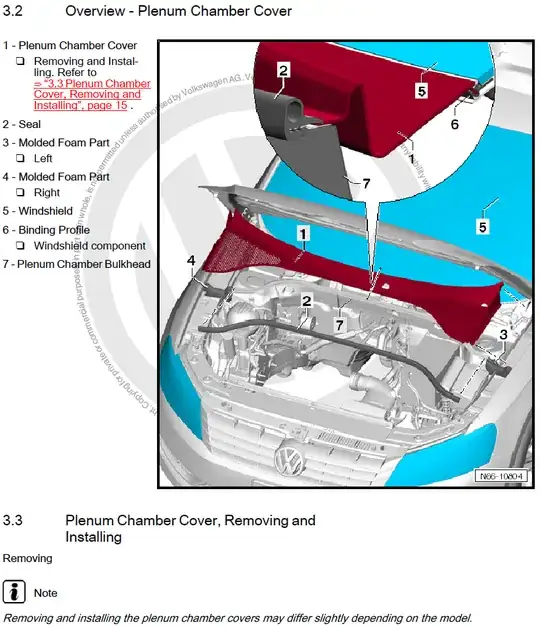

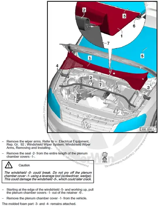

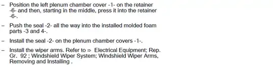

Plenum Chamber Cover:
