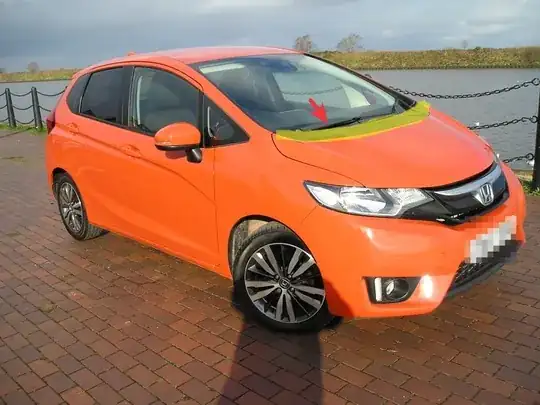

Context: The driver-side washer nozzle (red arrow on the picture below) of my UK 2015 Honda Jazz is losing pressure (the jet is very weak). I want to investigate the cause myself.
To inspect the washer nozzle itself, I need to unmount the plastic cover (yellow highlight on the picture below) that protects them. I have found to screw to remove from under the hood, yet this isn't sufficient to remove the cover. I can by gently bending the cover (but it's too tight to take a picture) that it is still attached to the bonnet via a green part that looks a bit like a flipper bumper but I've remained unsuccessful in trying to detach it. (I'm not sure whether there is something to unclip, press, or whether a bit more force is required…)
Question: how to detach from the bonnet/unmount the plastic cover (highlighted in yellow on the picture above) of my Gen 3 Honda Jazz?
ebosi
  • 187
The cowl (plastic cover) is two pieces. It is held in place by two bolts and a number of plastic clips. You can use a screw driver or a trim removal tool to remove the plastic clips. See the diagram below.
