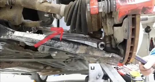

This is a common symptom of a worn constant velocity joint. The CV joint connects the driveshaft to the hub. It allows the hub to move with the steering while still allowing the driveshaft to connect to the gearbox.
The most common reason for the CV joint to fail is that the protective rubber gaiter that covers the CV joint has split, allowing dirt inside.
Try turning the steering fully to each end then rotate the wheel again. Does this make the clicking better or worse?
You can also look for splits in the rubber covering the CV joint.
I got this photo from this video where someone is replacing Fiesta CV joints.
