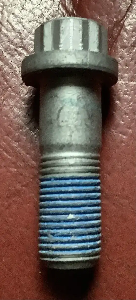

I have also seen a band of threadlocker already in place on new bolts that are used to hold brake callipers on.
