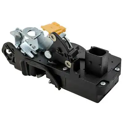

Here's some pics of the solenoid:
Stock pic

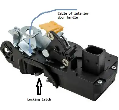

These show how the cable routes from the inside handle through so the metal connector lifts up when the handle is pulled and releases the latch:
What happens is, when the door is locked, and someone attempts to pull the handle to unlock it, the metal connector lifts up and the door correctly doesn't open, but the lip does not reset to it's normal position. So, when the door is unlocked, pulling the handle does nothing because the lip is in the wrong position.
