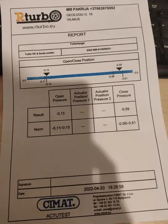

Service took turbine to the stand, and said turbine is ok, no need restration and replaced the thing which controls how much air to let in. So valve probably. The problem still exists - I am getting error and losing power when that light is blinking. Will call shop tommorow, probably they will say to bring car for diagnostics again and see what it will show.
Here is the paper from the stand: enter image description here
Update
The shop said there can be badly programmed computer after DPF filter was removed. So they called a programmer to reprogram it and it did not help.
They themselves do not know what else to do besides changing the turbine but looks like they are not confident about that also, they said they will discuss and let me know what they decided.
What else can be done? Is there a chance that changing turbine will help even after the stand showed it is working ok?

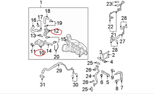

That model has a turbocharger with two valves. Using the parts diagram from here:
VW Tiguan Turbo Parts Diagram
You can see callouts 10 and 12:
Callouts 10 and 12
These are the "cutoff" valve and the "boost relief" valves. These are both electrically and pressure controlled valves that are designed to prevent the overboost condition.
In your case you need to determine which is having the problem and then either repair or replace it. A shop with a diagnostic stand will be able to determine which is the problem but you likely have no access to one, so you'll need to find out yourself.
My guess is that it's #12 as these types of valves can get clogged up with gunk and stop working. You may be able to clean it out with some carb cleaner. If all else fails, replace both.
