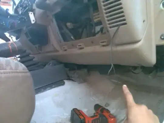

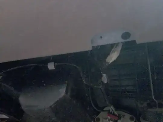

So, was working on my A/C and was trying to find the blower motor. from what I had seen on the internet, for the '99 Wrangler TJ's it is usually located under the glove box. now I did some digging around and found nothing. am I missing something?
where I was looking
Under the glovebox
2nd view

Unlike most blower motors found under the passenger side dash, your blower motor is accessed through the engine compartment on the passenger side. There are three bolts holding it in place. Below is a link on how to replace your blower motor.
https://www.youtube.com/watch?v=yL5Bzl2CTis
