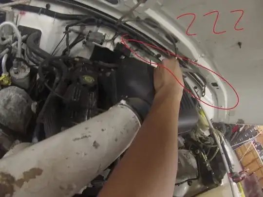

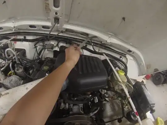

so i was filming for youtube and came across this random ground wire that wasn't bolted to anything, it's on a '99 jeep wrangler TJ, any of y'all know where this goes?
Random ground wire Random Ground wire #2

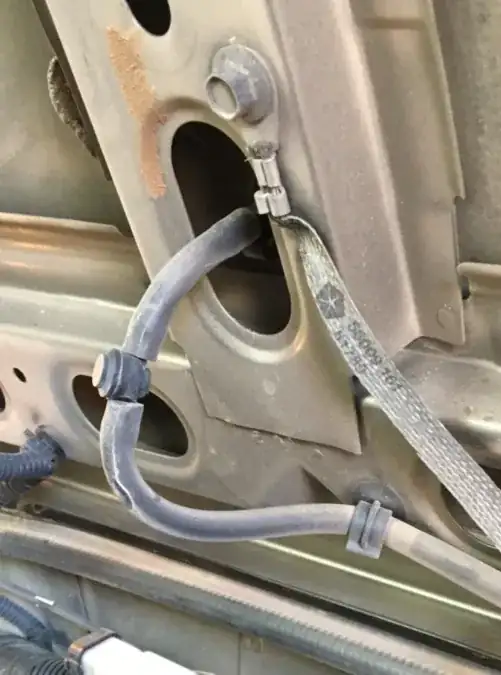

It should connect to the hood/bonnet.
I got this photo from here
I guessed it was from the hood and did a google search "jeep wrangler hood earth strap"
You can see the bolt hole in your photo.
Sometimes bad electrical connections on things like hinges can increase radio noise. The earth strap electrically bypasses the hinge.
