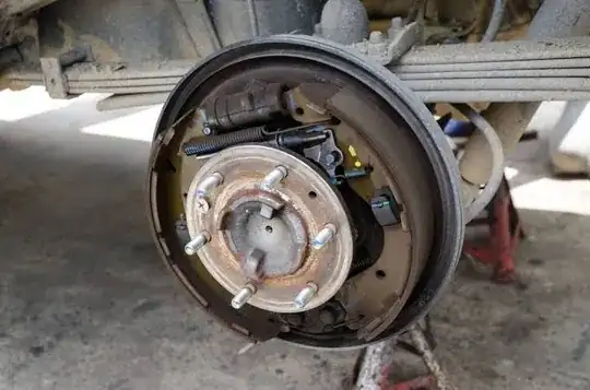

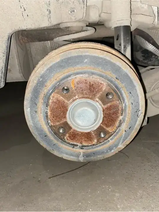

I have seen many videos and online tutorials for disassembling a drum brake, but they all look different. The ones I see online have the bolts emerging from the rim where the drum slides as the picture: enter image description here However, on my car(Peugeot 301), the drum looks a bit different as shown in the picture: enter image description here
I can’t seem to remove the drum no matter what I do, keeping in mind that it rotates freely and isn’t stuck in place by the brakes. So, does this type have a different way of removal, by bolts or something? Or does this center cap need to be removed first?

In the center cap, the drum is held on by a castle nut and there's a bearing in there as well. Pop the cap off and you should be able to see what I'm talking about.
