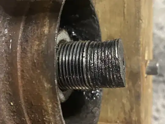

I went to replace a wheel bearing and noticed damage on the spline. The nut spun off fine, but I’m not sure if I should replace whole cv axle as well due to this. 2009 AWD FORD EDGE

J T
I would replace the entire unit. The reason being it is highly unlikely you will be able to get the nut to start correctly. The nut will wind up cross-threading and won't torque correctly. As a side note there is a reason almost all manufacturers design the axle end with a longer threaded section. I don't know what the reason is, but they don't add extra material and cost unless it is needed.
