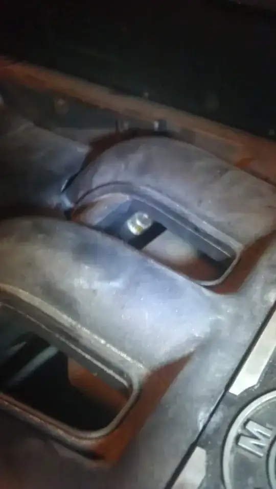

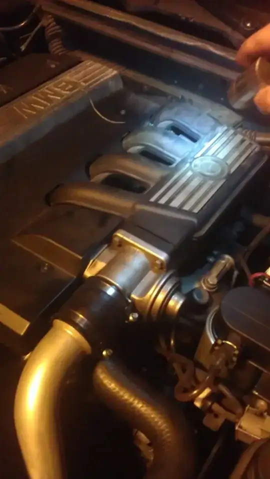

I can't manage to properly reach the top right screw (zoom picture of it on the second picture).
How could I do that ? (the tool I have is too long to be able to go on the rear, there is nearly no space !
Also, how to put the screw again without risking to loose it in the engine ? (I lost one screw in the engine this way !)
The place is nearly not reachable...

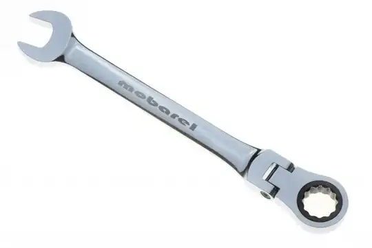

As there is no mention of any special procedure to undo these bolts in the TIS workshop manual, I would use something like this, a pivoting combination wrench/spanner:
Flexible Ratchet Spanner
The pivot should allow you to overcome the relative lack of space, while the ratcheting mechanism should save you oodles of time.
