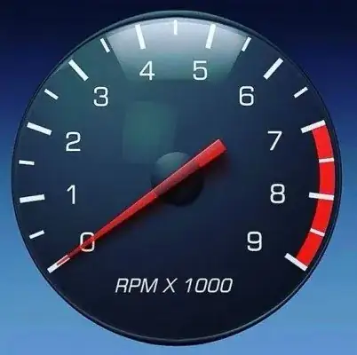

Experienced motorcycle rider and mechanic here. Take a sigh of relief, you are over thinking it. The answer you read from Quora sounds very much like it was advice simply suggesting for a new rider learning to ride stay at lower speeds till you get comfortable.
You are not going to hurt a bike driving at it's max speed, it is designed to do that. Instead the thing that does hurt a bike is if you constantly do something called "Red lining" (the red area in the gauge pictured). enter image description here
Red lining is where you max out the RPMs (aka tachometer) by putting a sudden load on the engine with actions like the full-throttle starts and rapid acceleration (which you mentioned the manual suggested not doing). If you are super concerned about riding style vs. wear & tear just avoid maxing out your RPMs, but again the bike is designed to do that. If you accidentally red line it is not the end of the world, just don't make a habit of it.
In my experience bikes are super sturdy mechanically. Try to focus more on learning to ride, important things to watch for while on the road, enjoying the experience, and most important having fun. The bike will be there to enjoy it all with you. Adventure far and ride safe!
