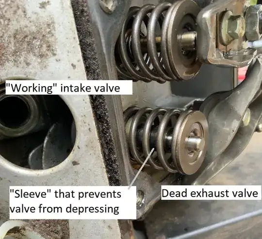

I finally figured out it was running on one cylinder only. After removing the dead cylinder valve cover, it's obvious why: the exhaust valve push rod was bent badly enough to have disconnected from both sides. The exhaust valve itself is stuck CLOSED, which explains the bent push rod. On further inspection, there's what looks like a sleeve (is this the valve seal?) around the valve shaft, protruding out of the head far enough that the valve will not push in at all. Tapping on the valve with a hammer slightly pushes that sleeve back into the head, creating enough space that the valve now moves.
valves and rockers
The intake valve seems to move normally. The intake push rod, however, also appears slightly bent, though still in place.
What could have caused the stuck valve? Any ideas for next steps? I don't think I can release the valve spring retainer, because I can't open the valve enough, without hammering the valve and its "sleeve" back into the head. I would be open to replacing the entire head assembly, but I don't want to do that if there's something wrong that's even deeper which would cause the same damage.
UPDATE: Removed head and everything looks fine inside: no visible damage. Ordered a new head assembly, installed (using torque and valve clearance specs), and everything runs great. Root cause: newbie mistake: air cooling fins and channels around this cylinder were stuffed with grass, leading to head overheating, leading to the valve seal coming loose and protruding, leading to stuck exhaust valve, leading to a bent pushrod and failure.

It looks like the valve guide has move out of the head. It is as you have described a sleeve that the valve stem slides in.
The valve guides are pressed into the head and should stay there. Other than it being a badly fitting guide, all I can think is that the cylinder head has overheated causing the valve guide to become loose.
Is the head aluminium? The aluminium would expand more than the steel guide when overheating which could allow the guide move.
Another possibility is that the valve stem has seized in the valve guide and then the piston has hit the valve head and pushed the guide out. If it has happened then the valve will likely be bent and the piston will be damaged.
There doesn’t appear to be much oil in the photo. Had you cleaned it?
You really need to take the head off and have a look at the valve and piston.
