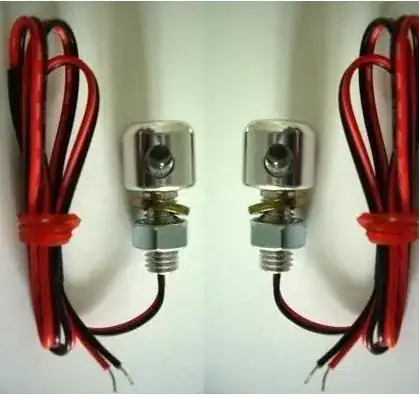

What about these lights as I discovered in this question
CHROME WHITE LED LIGHT NUMBER PLATE SCREW BOLTS

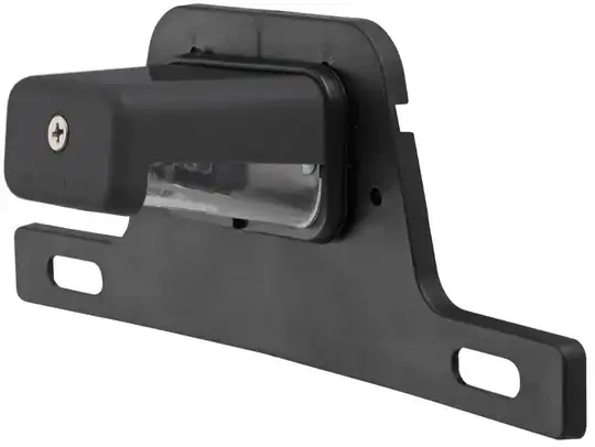

Or this one

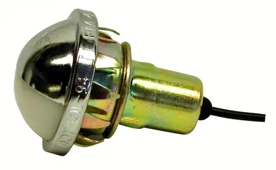

Looks like you just drill a hole for this one
