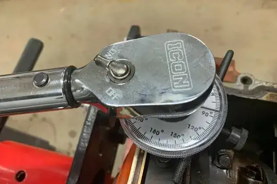

Car manufacturers state different kinds of tightening procedures for certain bolts. Some of them only state a single torque value (like 130 nm) while others suggest a low torque value (say 40 nm) plus an angle of rotation like 145 degrees. I read an article about the difference between the two but couldn't understand the concepts clearly. It said something about stretching of the bolt with angular rotation. What I need to know is that what really happens when you tighten a bolt in one-stage high-torque method or two stage (low torque + angle) method?
