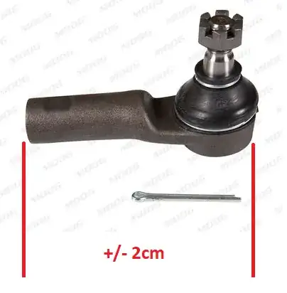

Impact of using a shorter/longer outer tie/track rod replacement part?
Are there any possible issues/wear on parts by using a part that is 1-2cm longer in length than OEM? Given all other dimensions i.e. thread/nut/cone size are identical? Also thereafter getting a wheel alignment done?
All I can think of is the possible difference of load on the tie/track rod axle joint? Should this be of any concern?

What you are talking about will have absolutely no difference in how the part operates once the alignment is done. The alignment is what gets the front end to where it needs to be. Once done, you'd never know the difference. If the part is made for the application, any length differences are figured into the part so are engineered to do the job.

That's going to affect the front wheel toe-in/toe-out. In other words, an important part of the wheel alignment. The question is can it be adjusted to the correct length by using the threaded portions of the component?
If you can get the correct toe-in spec by threading the tie rod end in or out then yes, you should be able to use this part. If not, then find the correct part.
