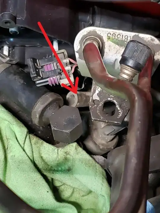

I just finished replacing my intake manifold gaskets. While reinstalling the fuel line bracket, I found this hose toward the rear of the engine. I checked my disassembly notes and photos and I don't have any recollection of having disconnected it from anything.
What is this hose for?
Some more info:
  • It also doesn't have any more slack in the hose to pull any further forward.

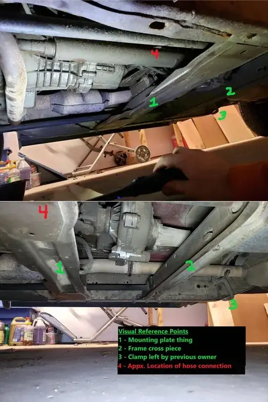

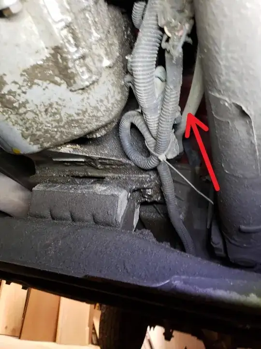

  • It connects to something just forward of the fuel tank (2nd photo) (forgive my ignorance, but I don't know the name of what it connects to)
  • It has a hose clamp, but its about 12" from the end of the hose. (but that makes me think its supposed to connect to something)
enter image description here enter image description here enter image description here enter image description here

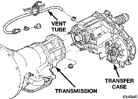

After a bit of googling, I think its a vent hose off the transfer case. Would love a second opinion on this.
ak_
  • 150
i just finished a job with same trans . thats the only hose that comes off of the top of the case is the vent tube , and also connects to another hose then runs over to frame rail and up to top of firewall. hope this helps 37yrs greasy, experience.
