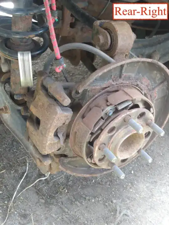

Now the issue is the following. I installed the left first. When I was about to install the right side I notice that the remain calliper would have the valve on the top and the old one has. Here is a picture.
In the Rear-Right picture you can still see the dust shield, but that is just hanging there. I would try to do some welding on it to avoid it falling, but again I got bigger rotors, so I will just take it out. If I had the right rotors it would eventually fall out when driving.

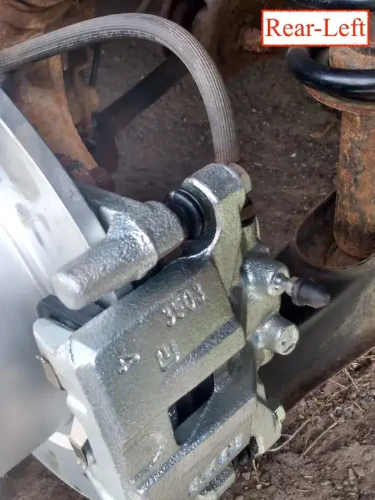

  3. Is it possible I mounted the calliper wrong, given the Rear-Left picture above?

Examine your original right rear brake caliper. Do you see the bleed screw on top? The replacement should have the exact same configuration. If you try to mount the other caliper and its bleed screw is on the bottom, you'll never be able to bleed it since air floats to the top with only brake fluid coming out. Whatever mistakes in stock numbers are made, calipers are mirror images of each other but not interchangeable from one side to the other relative bleed screw mounting. Examine both rockauto images. Both have bleed screws drilled and tapped on one of two casting bosses. Each one to fit only one side relative to bleed screw position.
