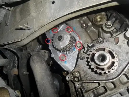

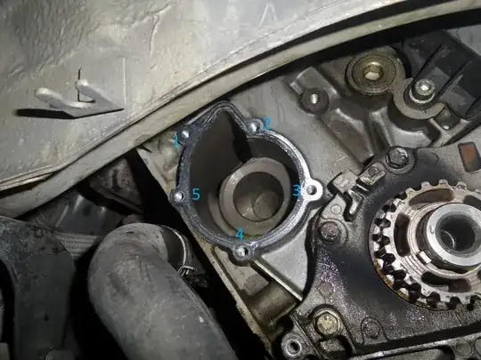

I'm curious about the tightening sequence of this water pump. The manual says nothing about it. I have included 2 pictures and assigned numbers to the bolts. What sequence do you recommend for this type of water pump?

If there is no tightening sequence listed in the service manual, I would just use a star pattern. Probably 1,3,5,2,4.

Tighten evenly, and to the torque specified but you have that from the manual.
